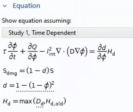

I am trying to reproduce the Phase-Field Damage + Solid Mechanics coupling using only Solid Mechanics together with a General Form PDE in COMSOL 6.3. In the built-in Phase-Field Damage model, the Equation View shows in the picture.
i.e., the history variable Hd is the maximum between the current driving force Dd and its previous-time value Hd,old. When I implement my own PDE, I introduce a scalar dependent variable Hd and I would like to enforce the same update:Hd = max(Dd, Hd,old)
