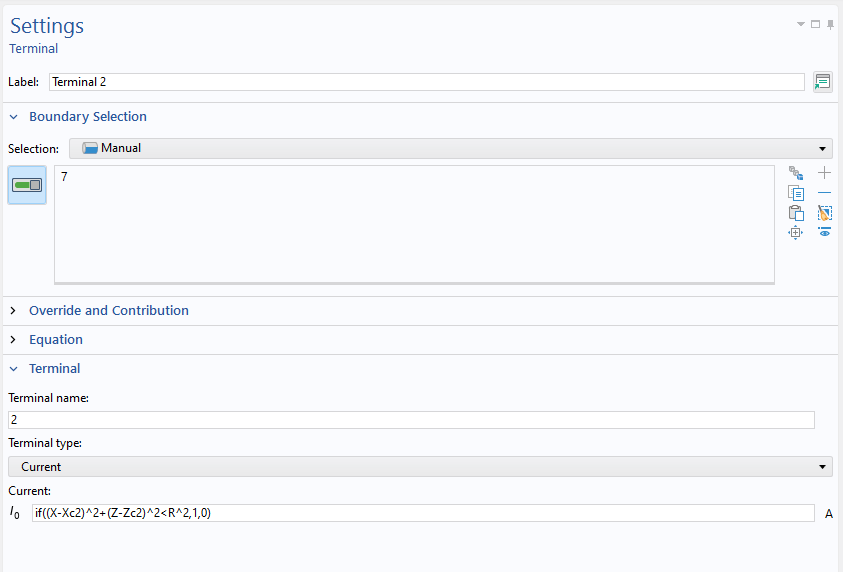

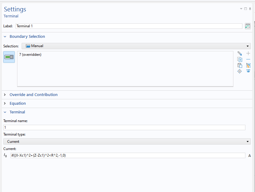

I am using the electric currents module and want to apply terminal and ground conditions to two circular partitions on a face. I replaced the ground another terminal to act as a sink (since the ground condition has no option to provide the equations).
I am giving a conditional statement like the one you mentioned but it is actually selecting the entire surface instead of a circular region.
Appreciate any help debugging this.
For more detailed help, I suggest that you contact support.
However, I think that one problem here can be that terminals are overriding features. So you can only have one Terminal node active on a certain boundary. That is, if you want to have several conditional terminals, you need to pile up all expressions into one Terminal node.
