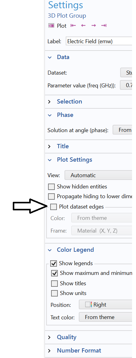

Posted: 7 months ago Dec 27, 2025, 11:34 a.m. EST
To hide edges in post-processing, consider unchecking the "Plot dataset edges" checkbox under Plot Settings in the Settings panel associated with your plot. For example, see the snapshot attached.
Posted: 7 months ago Dec 28, 2025, 1:05 a.m. EST
Thanks Robert for the reply, it works well.
