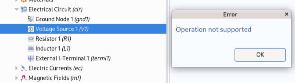

My workplace just migrated to COMSOL 6.4. All of the models I developed in 6.3 are not working because of an error in several Electrical Circuit (cir) elements.
I have five elements in my model: Ground Node 1, Voltage Source 1, Resistor 1, Inductor 1 and External I-Terminal 1. The Ground Node 1, and External I-Terminal 1 work as normal, when I click on them the GUI displays their settings. Clicking on Voltage Source 1, Resistor 1, or Inductor 1 produces a pop-up Error box with the text "Operation not supported" and a single OK button. Clicking OK closes the box but the Settings window is empty.
I have recreated the Error in multiple old model files.
I created a new model in COMSOL 6.4, added Electrical Circuit (cir) physics, and then added a Voltage Source. The Error was present in the new model as well so its not simply back compatibility, something is not working with the Electrical Circuit (cir) elements themselves.

Hi David, I checked the model on my Windows 10 installation and didn't receive an error when clicking on any of the circuit nodes. It didn't run because the setup is not consistent.
Cheers Edgar

I don't see any issue either.

I've opened up a support ticket on this (probably would have been better to do that first).
We've narrowed it down to some sort of installation error on on our network version but haven't fixed it yet.

In the ec intfc it looks like you need to change electric potential to boundary terminal and then select pulldown menu "circuit" so that you can add in an "external I vs U" node. this should fix setup is inconsistent issue.
you can also add in the external feature separately but apparently comsol at least asks you this these days.
