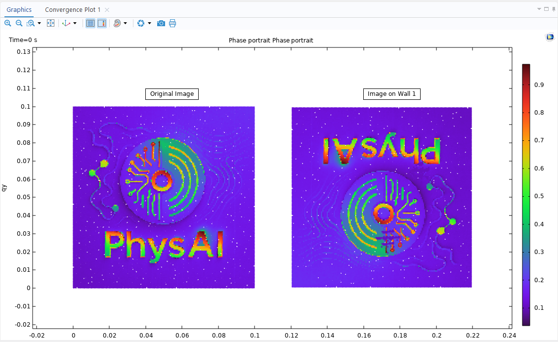

Hi, you are releasing rays from domains rather than boundaries, and adding detectors on domains rather than boundaries.
There are different ways of getting the image projected on a surface. I think in your case, following the method in the attached model. The two Phase Portrait plots in the Image Projection plot group show the appearance of an image from the release point of the rays (left) and on the target surface (right).
Daniel

Posted: 4 weeks ago Nov 11, 2025, 10:57 a.m. EST
Hi Daniel - thanks for the response and included model. It appears to be working now and a cursory few runs with sample values are producing results ~on the order of about what I expected. Thank you! Now I can play around and learn more about the module and physics options.

After some more inspection, my only q is that even when stepping down transmission in the cross grating to an unreasonable number (~0.001) the original image of the Phys2ai logo appears the same on both sides. Shouldnt this not be the case?
